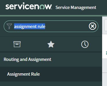

sachin_namjoshi
Mega Patron
You should use OOB assignment rules routing configuration table.
This table is used even by advanced work assignment engine.
This way you don't need to maintain assignment rules in different objects ( e.g business rule, script includes, workflow, flows etc)
It's easy to maintain and you don't need any customization.
