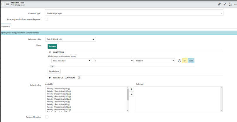

Requirement is to create interactive filter from the task_sla table with the following condition.
Table: Task SLA (Task Type is Problem)
- Problem Opened - Single.

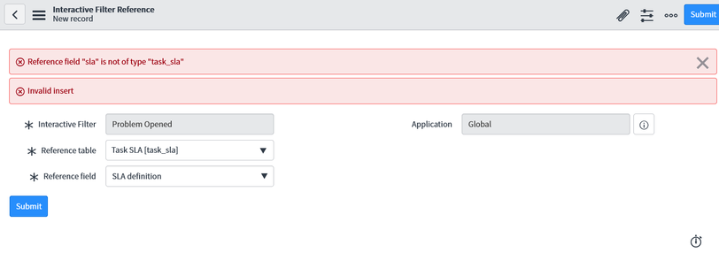

The filter was created but I am having issue creating the interactive filter references because I always get an error. Below is the screen shot for the interactive filter that was created.
Please assist on the best way to get this done
Interactive filter reference

If you want to filter by SLA definition, you should create the interactive filter on the 'contract_sla' table and not on task_sla. Then in the 'Interactive Filter References' tab, you can map this to the corresponding field your report is based on.

01-05-2023 02:13 PM
@laszloballa Thanks for a quick response. Can the interactive filter reference tab to map to task from task_sla table?
01-06-2023 02:09 AM
No, contract_sla table has no reference to tasks. You need to map the filter to the 'sla' field on the task_sla table.
This will work if you want to filter by SLA, which I am only guessing based on your previous post.
