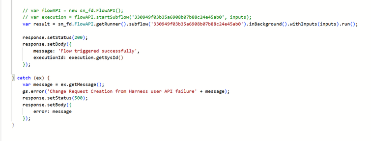

05-26-2025 04:17 AM
Hello Ankur,
I have configured it, But when I try by clicking "Explore REST API" and I am passing cmdb_ci --- 'Sys_id'
It is saying "Flow object doesn't exist".
Can you help me please here?
My SCRIPTED REST API CODE:
Next I created a Sub flow and configured the inputs like,
ci
startDate
endDate
desc
sd
like what ever the keys are present in the scripted rest api
and also mapped the values using data pills in the flow in Create record action.
I am getting this error:
05-26-2025 04:28 AM
you are not calling subflow properly.
Please check the syntax and make the changes accordingly.
