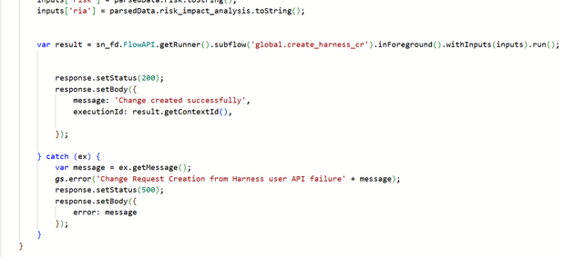

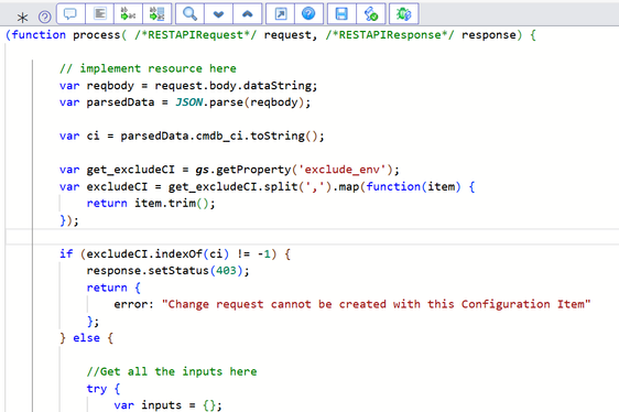

For your reference, I am pasting my Scripted REST API code:
Lucky

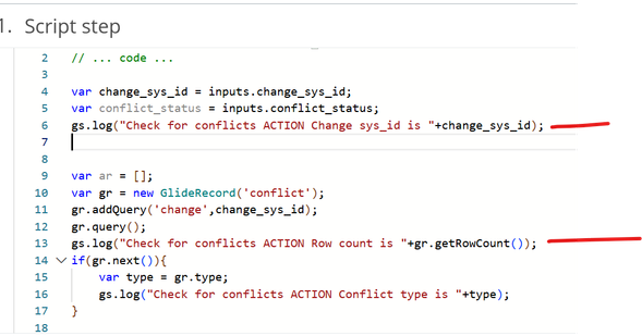

05-27-2025 12:29 AM - edited 05-27-2025 12:41 AM
Hello Ankur,
In line number 6, I am getting the created Change request sys_id
but in line number 17, I am getting the Row count as 0.
When I write the same script in scripts background, by hard coding the sys_id, then it is giving the right value.
Actually in the line number 13, I have updated like this,
Where it went wrong here?
