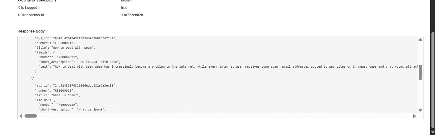

However, I am facing an issue with the search results.
When I send my search query using the payload, the response contains some irrelevant knowledge articles along with the relevant ones. I only want the results that are actually relevant to the user's search query.
For example, if I search for a specific topic, the response contains the expected KB articles, but it also returns other KB articles that are not related to the search.

The response showing the irrelevant KB articles

Also, your Scripted REST API is returning 5 results. If you want to return only highly relevant results, I would check the response handling in the script as well, rather than adding an arbitrary relevance threshold.
This should help narrow down whether the issue is with the synonym, boost rule, or API result handling.
