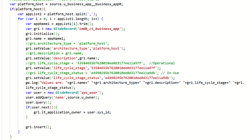

Hello all,
I have written on before Transform Script and the logs are giving the values but not setting the values into the record created. Any idea why they are not inserting?
I tried with the commented lines as well.
Lucky

Hi @Lucky1 ,
have u checked the table identification rule whether that is preventing insertion.
And alternatively you can try same script in onAfter transform script and verify
Please mark helpful if it works for you
Thanks, GP

Hi ,
Thanks for your reply.
Yes, I checked in the CI class manager, there are no rules defined on this table.
One more thing is, I tried inserting a record using background scripts, but it is creating empty record but without values.
What could be the reason?
Lucky
07-13-2025 11:28 PM
Hi @Lucky1 ,
I tried with below code and it created record in business application table from background script.
setWorkflow(false) is optional. you can try once.
Thanks, GP

this is onBefore or onAfter transform script?
which logs came?
