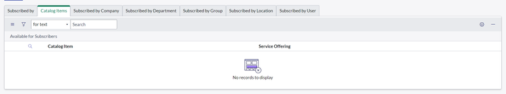

@s4scott There are additional subscription tables on Service Offerings which are not shown by default.
