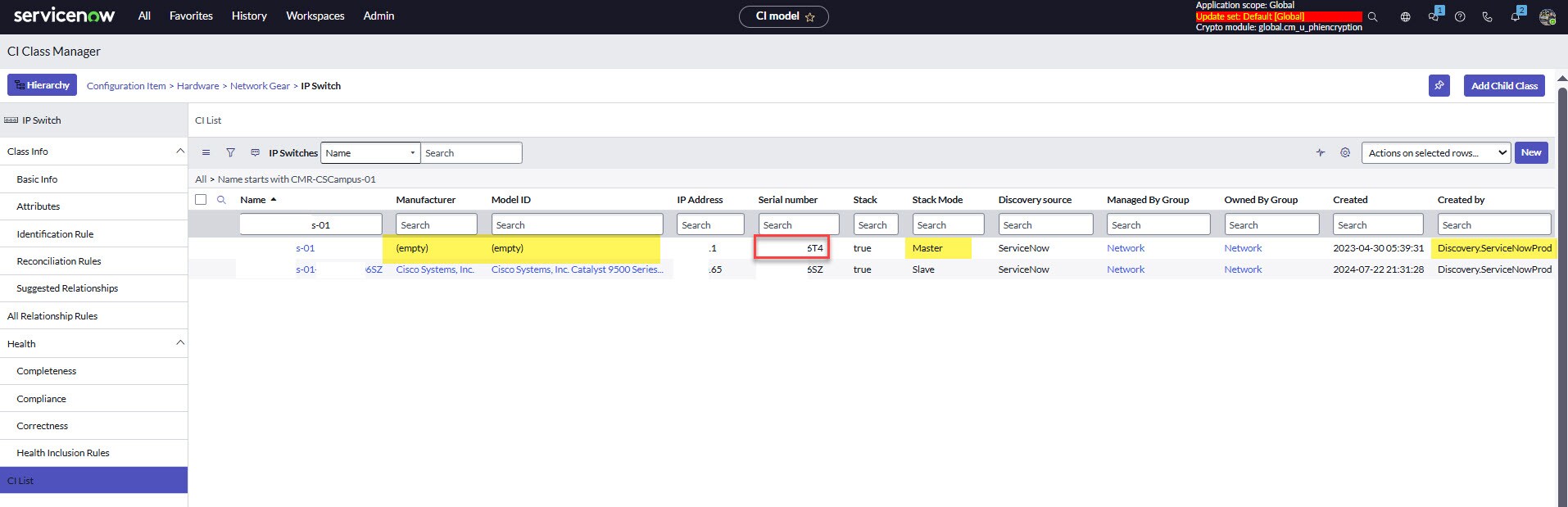

Situation:  I have ONE Cisco IP Switch, Cisco Systems, Inc. Catalyst 9500 Series Switches C9500-48Y4C.
I set the Manufacturer and Model ID manually and Discovery blanks out the Model ID repeatedly for the last year.  Left alone, and Discovery does not update the model.
Widget path: CMDB Data Foundations dashboard > Data Management Practices tab > Managed CIs Missing Model Entries widget
Things I have tried/checked:
* Checked the CI Class Manager for IP Switch
* It's STACKED partner unit does not do this, just this one.  Even is Master or Slave.  See pics.
* Hardware Model is only one model and is normalized.
* Set the Manufacturer and Model ID manually dozens of times, only to have Discovery blank it out and make my widget back off 100%.
Has someone seen this before?  Have a fix for it?
AJ_TechTrek
Hi @HeyMarkWarmack ,
As per my understanding Why this is happening:
What you’re seeing is a classic case where:
* Discovery (or its probe/pattern) runs → doesn’t get the model value back from the target (via SNMP, SSH, etc.)
* Discovery writes blank → which overwrites your manually populated value
* The data source (target switch) isn’t returning the expected model in SNMP sysObjectID, sysDescr, or the OIDs your discovery pattern expects
This is why it’s only happening on one switch, while its stacked partner keeps the model value.
