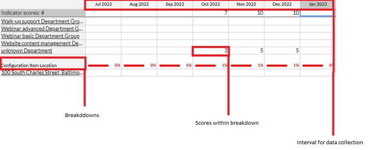

In PA I created an analytic to show the SLA Resolution Success Rate.  In the screenshot/attachment I am getting data, and it is correct at 99% up from 97%.  I created breakdowns for each indicator and applied the right jobs to each respectively.  Even after running the jobs, and I still unable to see the score for each assignment group [red box].  Can someone help me understand why the scores are not populating?  Thanks.

have you run a historical data collection from 1st of Jan? And have you attached the breakdown to all automated indicators and formula indicators?

Yes.  I checked.  Historical data collection [PA Incident Historical Data Collection] is already a job part of both the automated indicators and the formula indicator.

Eventhough that the PA historical job is part of the automated indicator, have you manually run the historical job?
If you go to your automated indicator --> under related links --> press "Scores for this indicator":
Do you see your different breakdowns with scores within the breakdown
