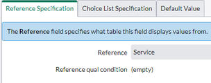

Have just tested a little on the parent field.
  1. If you remove the current selection and try to add in again, it will not be possible.
  2. According to bullet one, I would assume that this is an error in the PDI.
  3. You can make the parent be able to select Offering if needed, by changing the reference specification from service to cmdb_ci:
