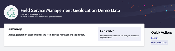

You can get the demo data after installing the plugin, by doing the following:
If your instance is in Vancouver:
1. Navigate to System Applications > All
2. Search for your plugin, you'll find it under the installed tab
3. Open it
4. Click on "Load demo Data" under quick actions
If you are using the classic App manager ( before Vancouver), you can do the following:
