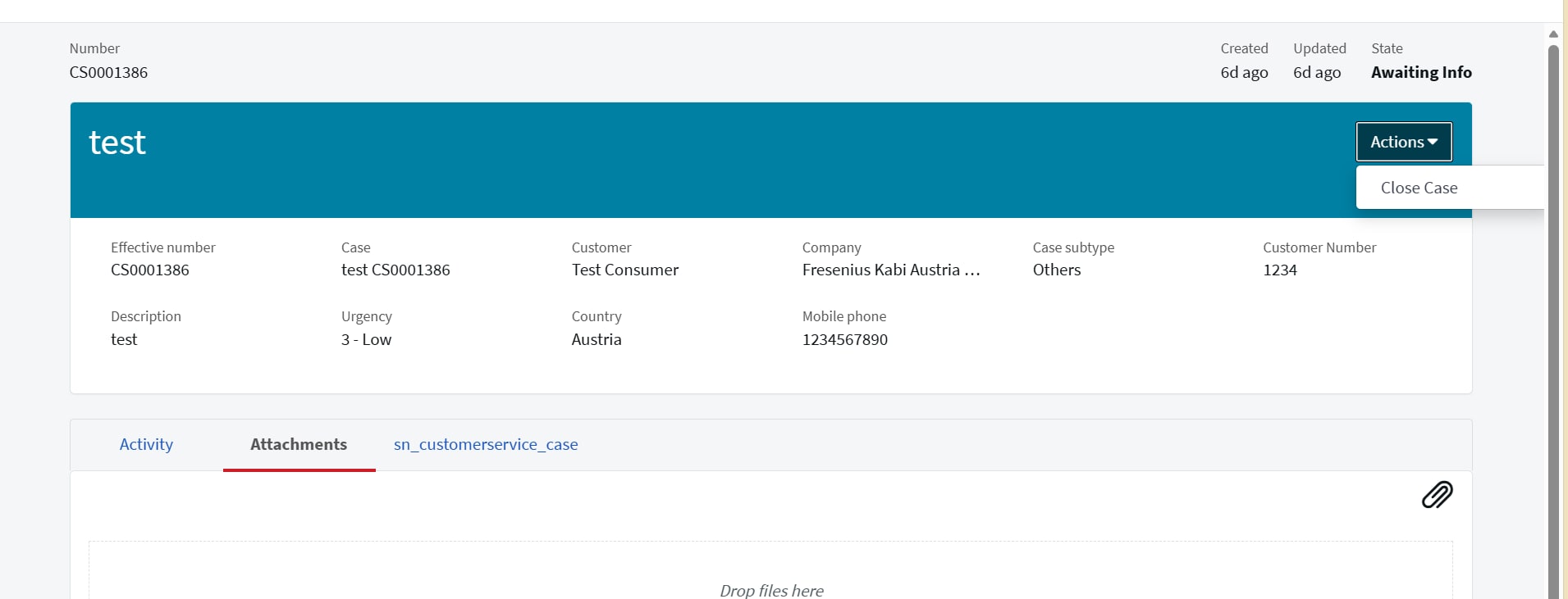

how to disable, sys_attachements paper clip icon on the portal for particular case where case state is closed i.e., state = 3.
Customer Service Portals

We can do by cloning the widgets but it is best to do the following configuration:
Go to All> Standard Ticket Configuratios.
Open the Case table record and in the related list on the Attachments tab and add the conditions so that the Attachments tab will be hidden.

where do you want this? on portal or native?
Simply block the Table level WRITE Access when State=3 and they won't see that icon
Note: users having table level write access will see paper clip icon

@jnfjn, May I know on which page the attachment icon i.e., widget is there on the portal
