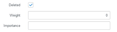

another thing that i just noticed is that they are being set as 'deleted' in the sys log ->emails. Whereas our Test instance ( which is still on Eureka) is not deleting them when they are received.
