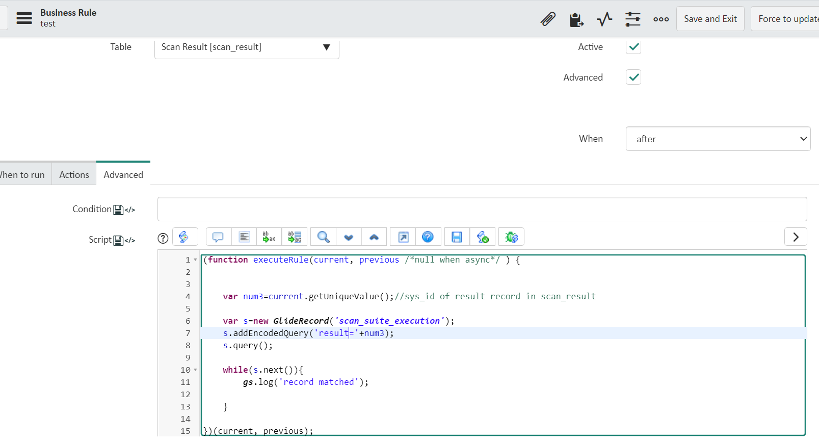

Able to fetch required result in background script but the same logic is unable to give expected results when ran on Business rules.
07-28-2022 05:43 AM
This the logic we tried in background script,working as expected it printed 6 times:
The same logic when tried on Business rule doesn't even print once:
Any help is appreciated!
Thanks.

Hi Aindrila,
Working with sys_ids can be tricky. The issue is around sys_ids not being strings. The general rule of thumb is to use code like this:
var num3 = current.sys_id.toString();
I suspect that adding a toString() to getUniqueValue() will give you the same result.
Hope that helps.

07-28-2022 05:59 AM
Thanks for your reply.I tried as you mentioned but still it didn't workout.
var num3=current.getUniqueValue().toString();//sys_id of result record in scan_result
var s=new GlideRecord('scan_suite_execution');
s.addEncodedQuery('result='+num3);
s.query();
while(s.next()){
gs.log('record is matching');

Hi Aindrila,
Have you run your BR through the debugger? That will let you see what value is going into num3. Also for debugging purposes you can add:
var sQuery = s.getEncodedQuery();
Did you try
var num3=current.sys_id.toString()
Hope that helps.

Try current.sys_id instead of current.getUniqueValue()
If still didnt work, then put a log for num3 and see what value is printed..
