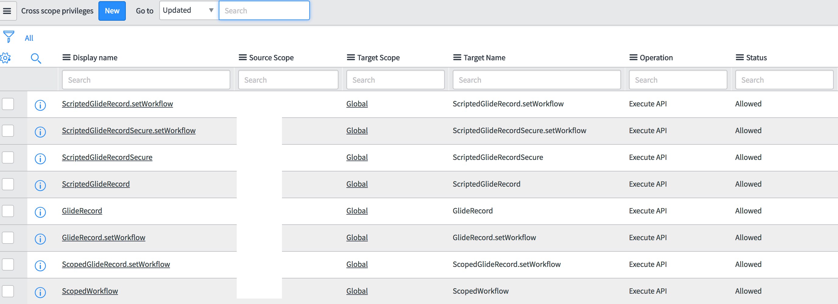

I have a simple task but feel like I'm hitting a wall. I need to call setWorkflow on a basic table (e.g. 'task' table) from a scoped application:
var gr = new GlideRecord("task");
gr.setWorkflow(false);
I know that cross-scope privileges required, so I created multiple (I'm just desperate to get it work):
And it still doesn't work. When I run those 2 lines of code in a script-background in a context of my scoped app, I get a message:
Security restricted: Access to api 'setWorkflow' from scope '----' has been refused due to the api's cross-scope access policy
Is that something missing in cross-scope privileges?

Did you try checking your app's access in "sys_scope_privilege" table.
You can read about the working of it here

I have to say that most likely it's just not possible to call setWorkflow on out-of-the-scope tables. Within the scope, it works just fine.
04-01-2022 03:56 AM
I ran into the similar issue. I have created cross scope access for setWorkflow, from my own scope to Global:
- I can call setWorkflow from my own scope, on my own scope tables
- I cannot call setWorkflow from my own scope, on tables in different scopes
