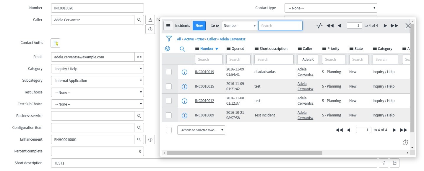

I've been trying to find out if I can access the code that defines the reference icon preview button. I have a requirement to develop something to display some caller info, without actually leaving the incident record. Now because of some limitations I can't add it to the popup_view, so I decided to do a new UI Macro.
The UI Macro onclick works fine, I used GlideDialogWindow and I can load the info. The thing is GlideDialogWindow loads a new window and kind of fuzzes out the rest of the page in the background. I was looking to do something more similar to the behaviour the reference icon preview has (loading the info on small window, on mouse over, without fuzzing out the rest of the page, and closing the window when the mouse leaves the button).
Is this achievable? Is there a way to see the code that is doing this for reference fields?

Small update, and in case someone finds this in the future: I did make it work. It's not the best solution, the code itself is not very elegant, and as Joe said since it's an unpublished API future updates might mess it up.
As you can see, hovering on top opens up this dynamic Popup , and in this case it shows up a list on active incidents for the current caller. Give me a shout if you're interested in the solution, but overall as I've said before, maybe it's not worth all the trouble.

‎02-24-2017 03:10 PM
Hi Jose
Finally got a chance to take another pass. Here is another option using GlideOverlay. It's still not a well documented API, but it is more generic and so I suspect less prone to changes that will make upgrades troublesome.
