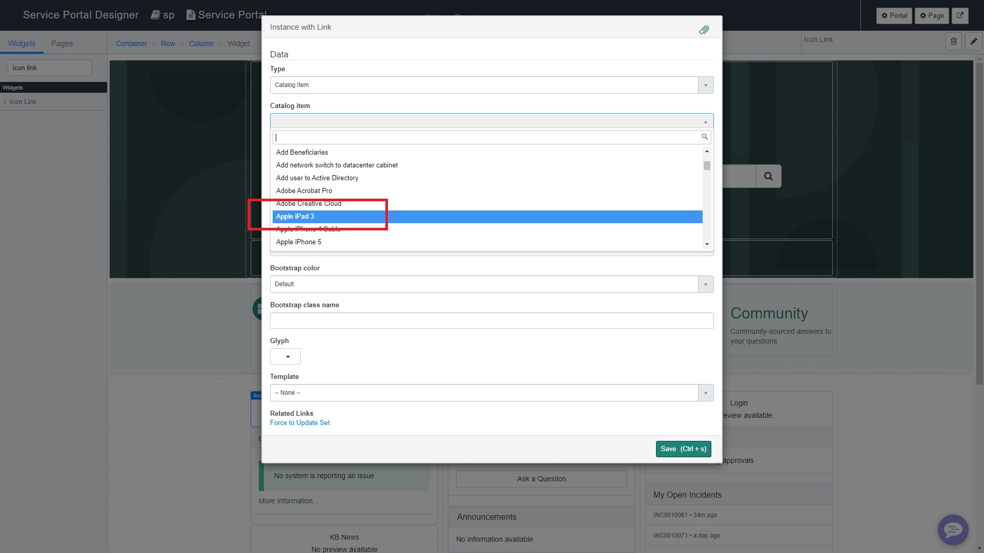

I find this very helpful the only issue I have is I do not know how I would go about adding sys_id as an instance option for the cloned widget.
Is there an article or thread that I can use to accomplish this?
Mark Roethof
Like this for example?
