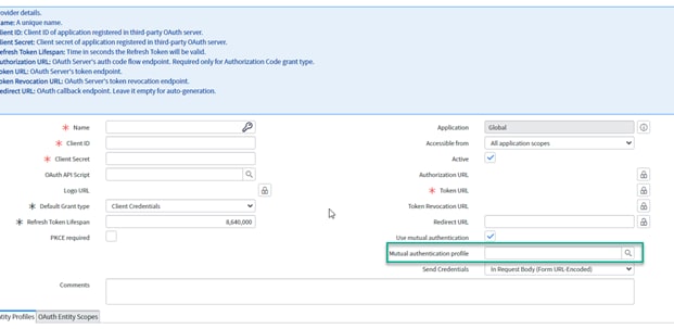

I wanted to reach out to the community to find out if any other organizations have implemented an ADP integration into ServiceNow for pulling worker information. Currently we are having a challenge with the OAUTH 2.0 configuration and getting a successful OAUTH token. Also we were provided a certificate and also a key file to use but we were only able to get the certificate only to validate. The key file is unable to be attached in the certificates section in ServiceNow as it will not validate.
Due to these issues, we are exploring mutual authentication as a workaround as provided by one of the cases we opened with ServiceNow HI Support.

06-23-2021 02:21 PM
Terry,
Did you get this figured out? I couldn't find a solution on the forums and I've been struggling with this for a while and I just got it working.
I first got everything working in Postman following ADP's instructions but could not get it working in SN...like everyone it seems.
When you create your Mutual Authentication Profile name it "adphttps" or whatever you like. This will be your protocol on the REST message instead of HTTPS.
On your REST Message use the Mutual Authentication Profile name you chose as the protocol for your REST message then select Authentication Type OAuth 2.0 and your profile like normal.
Save then run the Get Oauth Token Related Link to test.
