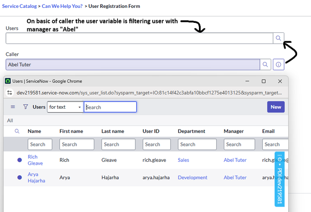

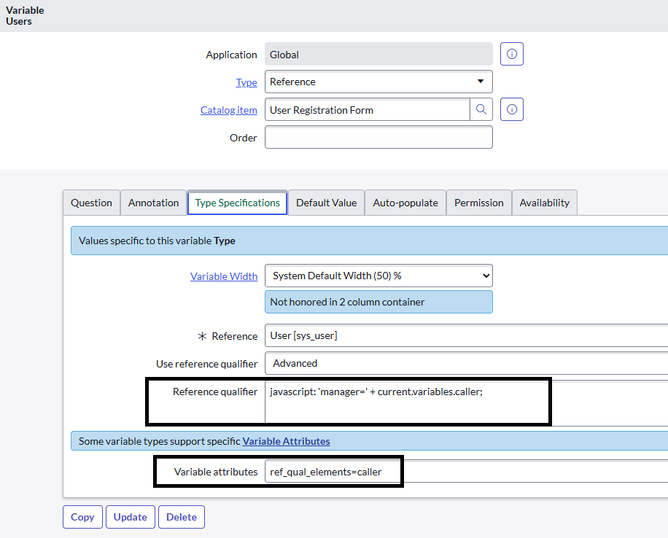

Hello @sna12578 ,
As per your requirement I tried in my instance so its working fine :
Having 2 variables : 1) Caller (manager),
                                       2) Users (user's under that manager)
Added that into catalog item as per your Function (caller) & Sub-Function(users) :
As a result getting filtered out users which are having the caller as manager :
Plz check some mistakes such as semicolon - after advanced javascript qualifier or fields backend value !
