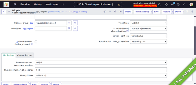

‎04-06-2025 07:24 AM
For showing all records at a time on the Dashboard You need set in widget-->List Setting--->Page size is blank or choose as maximum
You can sort it in ascending and descending as per your requirement.
Refer the screenshots:
This setting helps optimize performance by preventing excessive data loads that could slow down the system. Users may need to adjust this limit depending on their reporting needs, ensuring they can analyze sufficient data while maintaining efficiency.

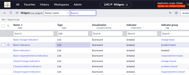

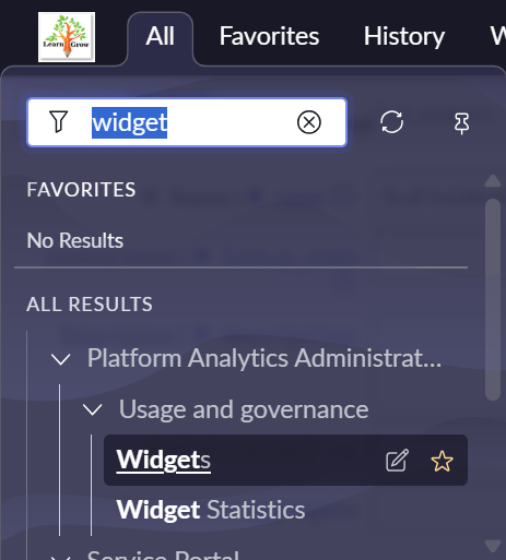

‎04-06-2025 11:08 AM
Search for the widget under Platform Analytics, then open the indicator of type List. From there, you can make the necessary changes.
