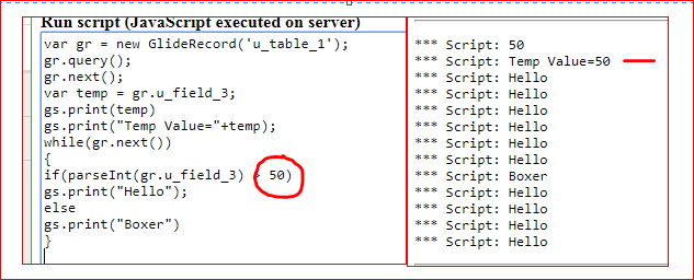

08-27-2017 10:03 AM
Hi Sishir please comment on the following ....
1) did you check the code with highlighted in the image
though the value of "u_field_3" is defined as integer in the table, still do we need to typecast !
3)
the last two images is having only temp value changed to 50 look at the o/p.
Total values in the table = 12;
and values are following
08-27-2017 10:17 AM
I can see in your table there is total 11 records.
when you run below code, how are you making sure that record will always get you the temp value as 50? The better way to use GlideAggregate to get the Max value of the field and then do the comparison (as sugegsted by Deepak).
var gr = new GlideRecord('u_table_1);
gr.query();
gr.next();
var temp = gr.u_field_3;
If field type is integer then i think type casting is not required, you can check and try.
in your 3rd screen shot you are using parseInt(gr.u_field_3) > temp, but variable temp is not an integer, you can change it to gr.u_field_r > parseInt(temp) and try.
It is always recommended to use getValue() instead of directly accessing the field value with gliderecord.
08-27-2017 11:38 AM
Hi Naresh,
may i know what exactly are you trying to accomplish here.
if i check the 4th line in your query , it will always return you minimum integer value .eg: if you have list of values stored in u_field_3 (10,20,30,50,60)
It will always give you 10. do you have any set of numbers that you need to compare with u_field_3 values.
var test='';
var abc= new GlideRecord('u_table_1');
abc.query();
while(abc.next())
test=abc.u_field_3;
if(test>50)
gs.print('it is a demo');
else
gs.print('help');
