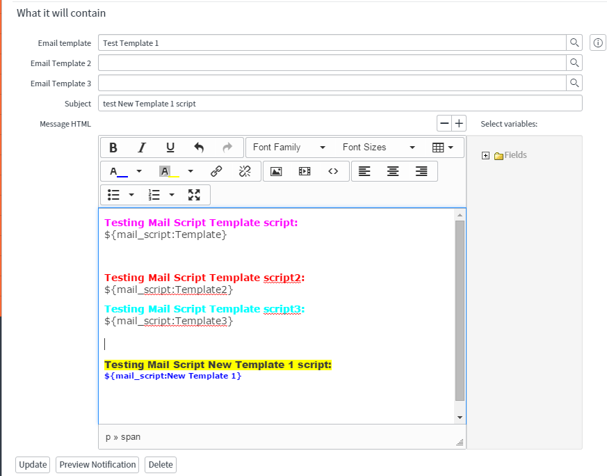

Email will contain this:
So now, you could just change the template fields on the form, and not have to worry about constantly changing the ${mail_script:name}   in the body of the Message HTML

  3. Edit the Email Notification with your   new script

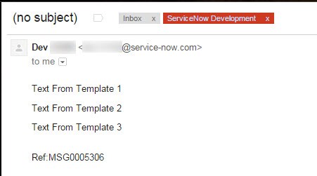

  4. Trigger the email:
    • Here is what was delivered.
    • Notice that the Template Script 2 and 3 are blank?   that is becuase the template fields on the form are blank. as seen in #3.
    • So you can do it either way.
