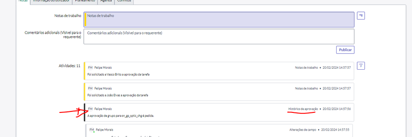

I need to hide the "approval history" messages from the end-user, since it appears on the portal as "comments". My solution for that was to change those approval messages to being populated as 'work-notes' instead of 'comments'
And it worked for the individual approval message, such as "user01 was asked to approve the task", but not for the group approval message: "Group approval for group_name is requested.", for instance.

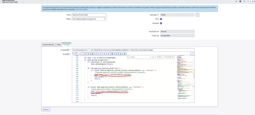

To do that, I changed the journal update lines in the Approval Events (Task) business rule:
But i can't find where the message of the "group approval" is coming from. I already checked Approval Events (Task) and Approval Events (non-Task) BRs and on the WorkflowApprovalUtils script include, but wasn't able to find it.
Does someone knows where this message comes from so that I can achieve that?
