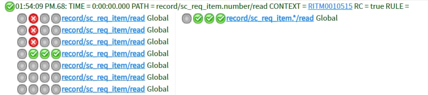

find_real_file.pngThis is the READ lines in the debug for it...the only blocked read in on comments... that's not something I added..but didn't change it.. no need for the approval to comment on the RITM itself.. should only be on the approval record.  I notice the item field isn't visible on this form... maybe something on task it blocking it
