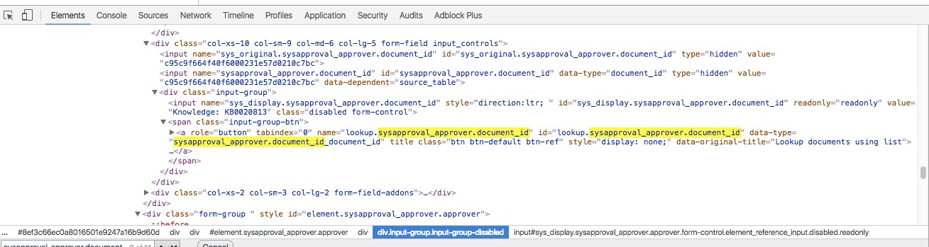

Chrome dev tools at least has the element showing with a value. When I hover my mouse over the element, nothing is highlighted on the form like what happens for other fields like "Approval for".

Deactivate ui policy and check
Ui Policy:
"Check for presence of new document_id field. If it is not on form, display the legacy sysapproval form."

I am an idiot. I missed a UI Policy. We did have the one you mentioned disabled but we had another one called "Hide / Lock down field always". I swear I disabled it when testing but when I looked back at it again it was enabled. Maybe if I had taken the time to read the name or actually open it then I wouldn't have had to have made this post in the first place.
