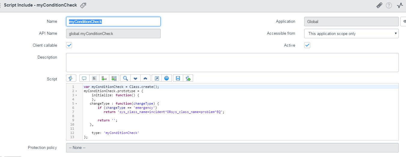

Look at using an advanced reference qualifier (a script of your choosing.) Pass the function your type, it can then return the proper filter string (either the above or nothing.)
javascript:myConditionCheck().changeType(current.type);
var myConditionCheck = Class.create();
myConditionCheck.prototype = {
initialize: function() {
changeType : function(changeType) {
if (changeType == 'Emergency')
return 'sys_class_name=incident^ORsys_class_name=problem^EQ';
return '';
type: 'myConditionCheck'
http://wiki.servicenow.com/index.php?title=Reference_Qualifiers

Hi chuck,
Just a minor correction to the code, the function parameter and the variable you are using inside if are not same.
01-06-2017 06:40 AM
Thanks. Updated.
