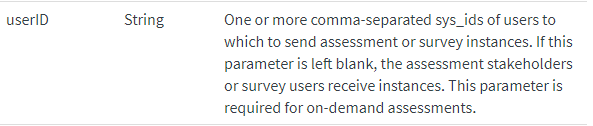

Going by the SN docs I'm not sure what's wrong [since this error message is not mentioned], since the survey actually does have questions:
Trying to run the same line for survey instance creation in background scripts, but trying to use the 'AssessmentCreation' object/class as they specify in the documentation above tells me that such a function does not exist.
