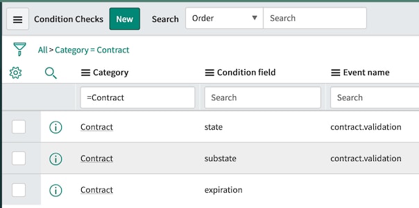

While the business rule - Manage Contract Lifecycle - is driving the state changes, the BR is getting what data to set from the Condition Check Definitions (module). Out of box choices look like this:
There is also a Scheduled job that runs daily named - Contract: Run Condition Checks - that checks the contract data against this table and moves the State/Substate based on the conditions defined in this table.
So a) confirm your workflow is running, b) confirm the condition checks table is populated correctly.
