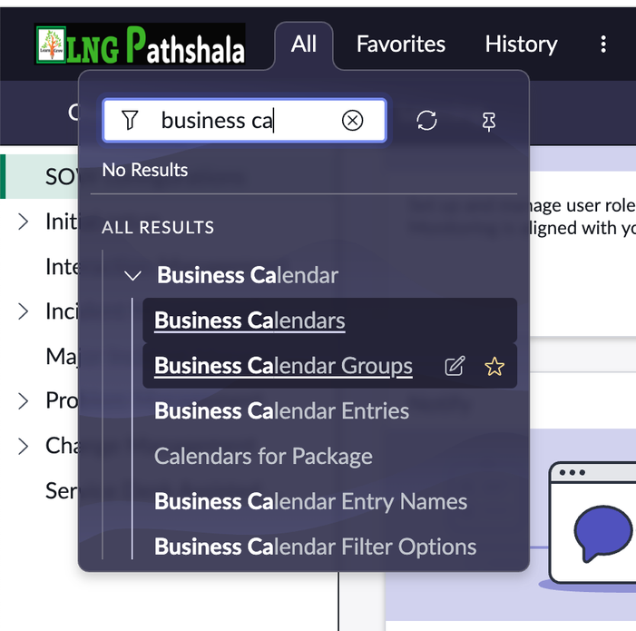

Hi @Suyong
Regarding points 4 and 5 — the Business Calendar refers to the OOTB (Out of the Box) business calendar, where you define the schedule.
Have a look here for reference.
