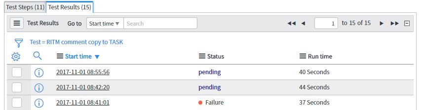

Either way, my test still fails, this time at the custom step configuration.   Strangely enough, even though the test run tells me the test failed, the test results log shows those tests as pending.
Have I incorrectly created my step configuration somehow?
