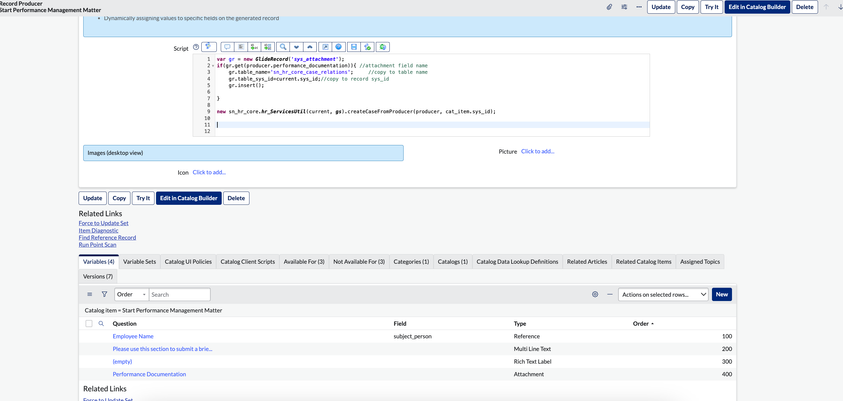

Hi there,
I have added the script on record producer to add the attachment variable to the attachment that is on top of the HR case. The script is below. Can someone please see what is wrong with the script. When I attach document to performance_doumentation variable It is not getting attached as attachment
var gr = new GlideRecord('sys_attachment');
if(gr.get(producer.performance_documentation)){ //attachment field name
gr.table_name='sn_hr_core_case_relations'; //copy to table name
gr.table_sys_id=current.sys_id;//copy to record sys_id
gr.insert();

07-19-2023 09:14 AM
if(gr.get(producer.performance)){ //attachment field name
gr.update();

@Simran321 Thank You for the reply.
I tried this but it did not work as I want to add an attachment as a public user.
