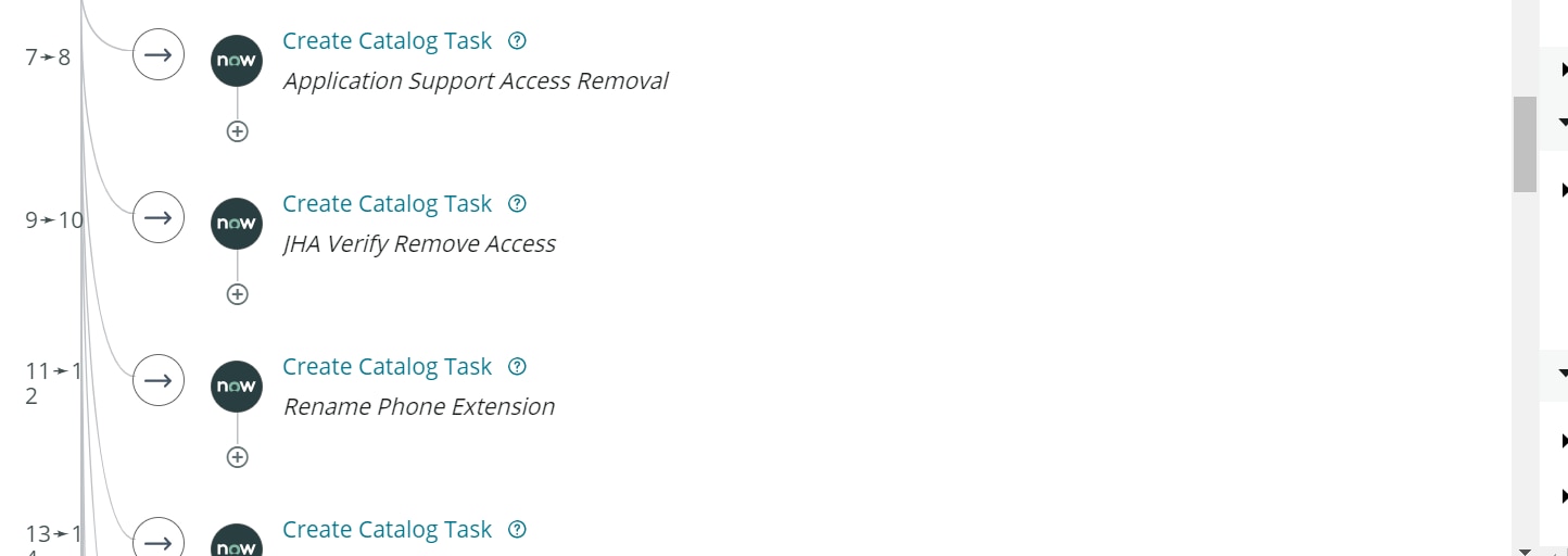

Good morning developers,
I know this question has been asked several times on here but I haven't found a solution that meets my requirements. The only thing I'm trying to do is automatically close the requested item once all catalog tasks have been closed using flow designer but nothing I tried works. Here are the conditions I'm using to update the requested item:
Could someone help me figure out what I'm doing wrong?
