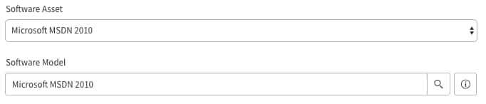

It's a little odd because both fields end up with the same display (because you had "model" as the Lookup label field):
But, I think it does what you are looking for.
