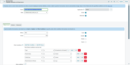

Can you please guide me regarding the After Business Rule to Auto populate a custom field named as"Physical Host Name" on a Parent Server record with the Child name once a CI Relationship is created.
Below is my sample script:

the screenshot is terrible quality, please when asking for help provide a readable one...
I cannot evaluate the trigger myself, but what you can do is TEMPORARILY change the condition to just one condition, e.g. "Parent class" [IS] "Server", then try to trigger it.
BTW what is the operator "IS A"?

try to keep just one single condition or not at all, to make it more trigerrable or check the script in a background script, have you logged it to see if it is triggered?

Hi @Chandrika4 ,
The issue is with how the parent CI is being retrieved. Since this Business Rule is on cmdb_rel_ci, you should get the parent using current.parent.getRefRecord() rather than current.getRecordClassName().
Also, since u_physical_host_name is a reference field, assign the child CI’s sys_id/reference, not its name.
(function executeRule(current, previous) {
var parentCI = current.parent.getRefRecord();
if (parentCI.isValidRecord() && !parentCI.u_physical_host_name) {
parentCI.u_physical_host_name = current.child;
parentCI.update();
})(current, previous);Make sure the Business Rule is configured on cmdb_rel_ci with After → Insert and temporarily remove any condition while testing. If the BR still doesn’t trigger, check that the CI relationship is actually being created on cmdb_rel_ci.
