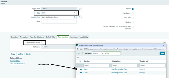

Hello, I want to add an employee start date field to catalog item that auto populates when a field titled "Who is the user receiving the phone is filled in. I added a variable titled "employee start date" to the catalog item, I made it type "reference" and I referenced my company's HR table. I then went to type specification and entered the required info. lasty, I went to auto populate, but my dependent question "employee start date" is not available for me to select. Please see the screen shot below of my steps. Any help is greatly appreciated.

If you want to auto-populate a variable named "Employee start date" when a variable named "Who is the user..." then the Dependent question on the Auto populate tab for the Employee start date variable is "Who is the user..." not the same "Employee start date" variable. "Who is the user..." needs to be a reference type variable for this to work, but you probably don't want "Employee start date" to be a reference as this will populate/appear with the display value of the HR table, which is likely not a date, so try making it date, date/time, or string.

Hello @DeIvory Gordon ,
There might required some changes in your setup,
Correct setup should be:
- Variable: Who is the user receiving the phone => type Reference
- Variable: Employee Start Date => type Date
Then you can select your Who is the user... variable for making start date auto populating :
