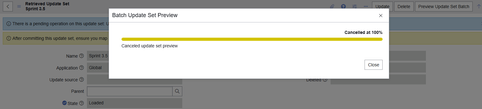

In my Dev environment I have 3 update sets batch  Sprint 1, Sprint 2, Sprint 3.5 . I transfer and commit Sprint 1 and 2 in my QA and is all fine. When I am trying to transfer Sprint 3 batch , when I preview it , I get the following:
and this message:
"There is a pending operation on this update set: Update Set Tracker:  <different child update set name every time I preview it> "
I see in other communites post, that this happens when you have same name in update sets inside the batch but when I transfer Sprint 1,2, 3.5 in my PDI, it was everything good. It doesn't cancelled. Have you ever faced something like this? Need help!

That's how the platform works !! Always verify in the batch if there no duplicate update set names ( that means no 2 update sets should have the same name).
