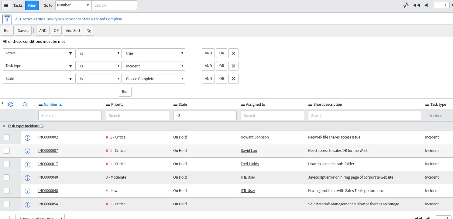

Well, it's a bit of a mess. But I think we can make up what you want. Which are the filters on each change/incident. etc. you want for the list?
Example... the filter doesn't really care about the label like onHold etc. it's the value behind.. and onHold has the same value as Closed Complete.. which leaves us to for example make a filter like this, showing all active incident with state "onHold". As you can see it shows "=3" in the search field below "state". not "=Closed complete" which it says in my filter.
