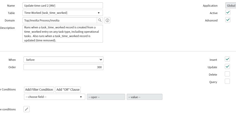

Hi
When you can post screenshot of the BR, and several people here ask for it, why don't you raise your chances for a resulting answer by just submitting the screenshots here?
BR
Dirk
Because the rule is not running at all, therefore its contents should have no bearing. But here it is, anyway....
