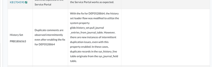

I could see this from ServiceNow
https://www.servicenow.com/docs/bundle/xanadu-release-notes/page/release-notes/quality/xanadu-patch-...
