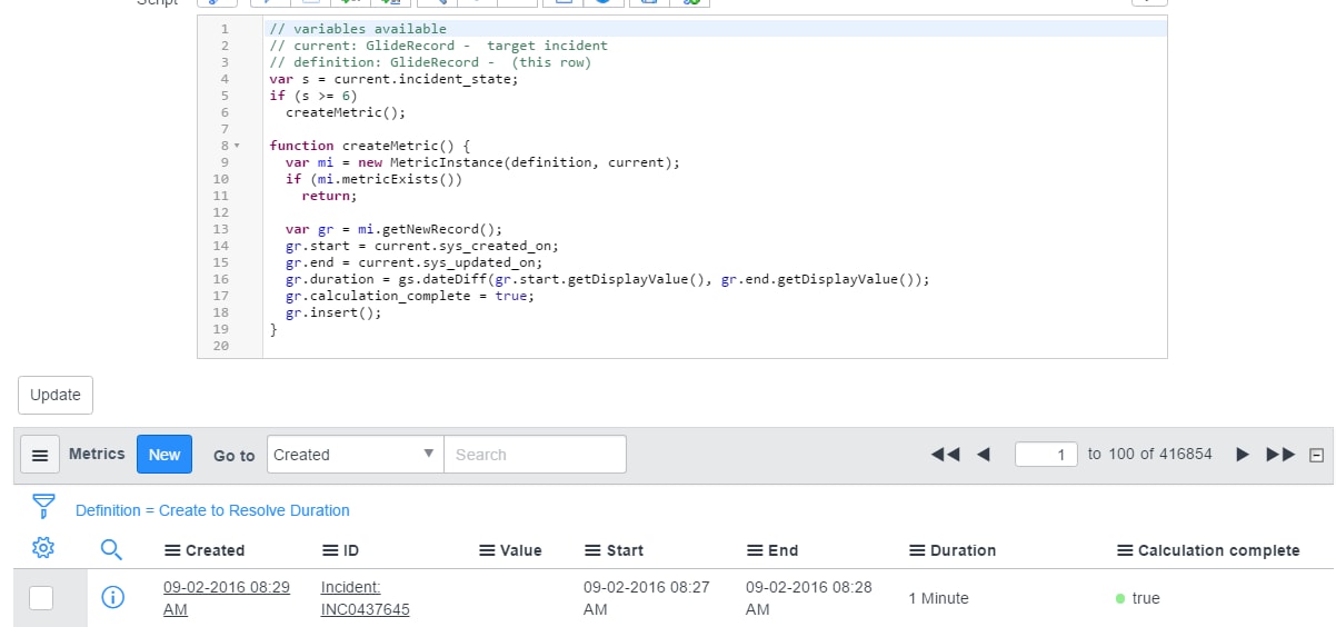

Hello All,
I am running into an issue with a current clients instance. They have their time format under the system properties as "hh:mm a" so all date fields are in this format "09-21-2016 03:43 PM" I am trying to set the value of a duration field using a start and end date but the issue is when I use gs.dateDiff(current.u_start_date.getDisplayValue(),current.u_end_date.getDisplayValue()); with the third parameter true/false or blank I get invalid results. because the display value excludes the seconds and has the am/pm.
Is there a way around this? Does Sn still store the seconds even though the format is excluding it.
I did some digging into the metric table and it is running this code and the start and end dates are the same but it is working, but not for my business rule.
This oob metric definition "Create to Resolve Duration" is running this script:(notice the am/pm and the duration is calculating)
