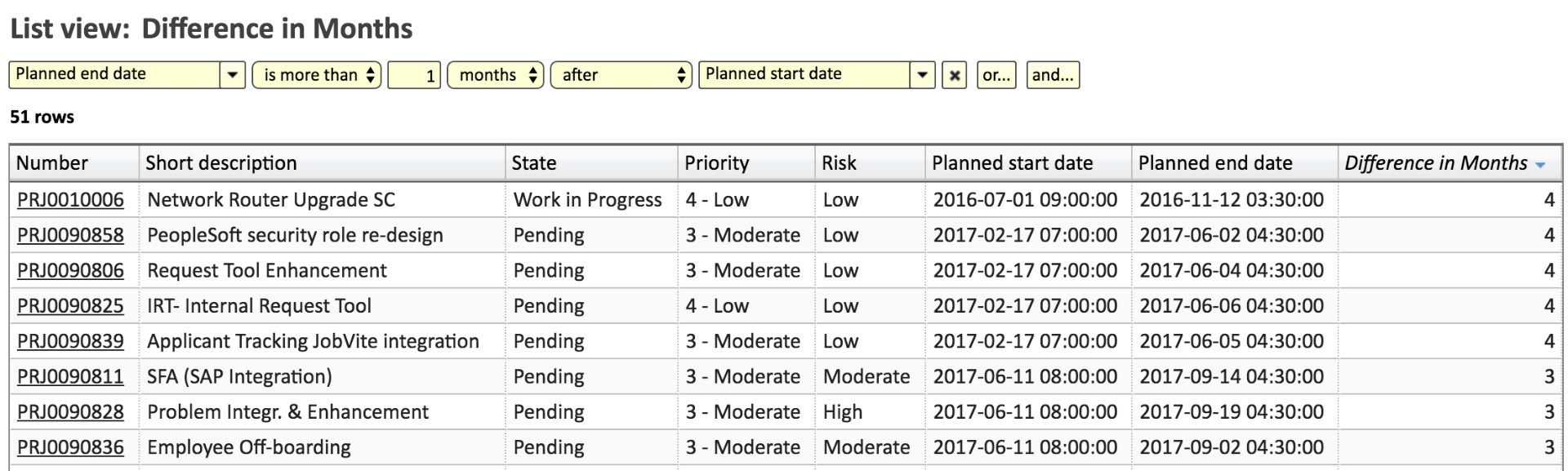

If in future, you're looking to do these sorts of calculations on the fly (rather than setting up a server-side javascript business rule), you (or your users) could use Explore Analytics to do calculations.
For this example, you could use calculation in a List Report on your table:
And then you can create a 'composite view' to use this virtual table in reports:
The report is live, drillable, and can be published to ServiceNow dashboards. If you're doing these calculations for reporting purposes, this may be a more scalable way to deliver these calculations without requiring code changes to SN.
Hi Guy,
        Thank you for replying; however, this calculation is inside of form that works with a backend table where the records are being written to after the form is submitted. So I am not sure how you solution would be helpful to my form. This information is very helpful from a reporting standpoint though.
Karen
