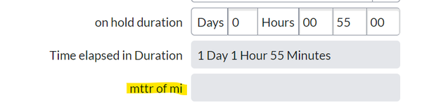

I have two customized duration fields 1. Time elapsed in duration 2. On hold duration.
Now my requirement is, I need to calculate time difference between above two duration fields and insert the output to another duration filed i.e MTTR.
MTTR= Time elapsed duration minus on hold duration.
Pls note,here all the field types are duration only.

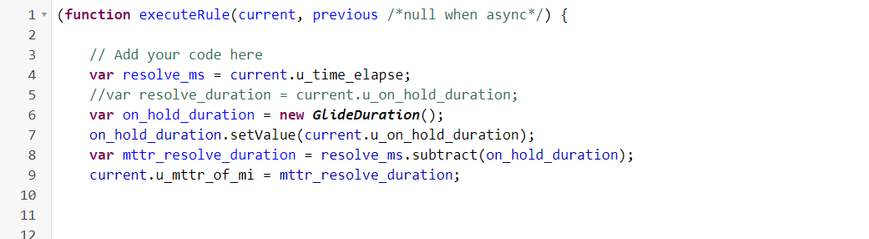

I'm try with below update BR, but not getting desired input. pls help me.
 kindly refer below snap as well...
Here my desire output is MTTR= Time elapsed minus on hold duration, then value(MTTR) should be 1 day 1 hour but here value I'm getting as empty.
Ankur Bawiskar
@sreenivas8
try this
var dura = current.u_time_elapse.dateNumericValue();
var durb = current.u_on_hold_duration.dateNumericValue();
current.u_mttr_of_mi.setDateNumericValue(dura - durb);
6 REPLIES 6
