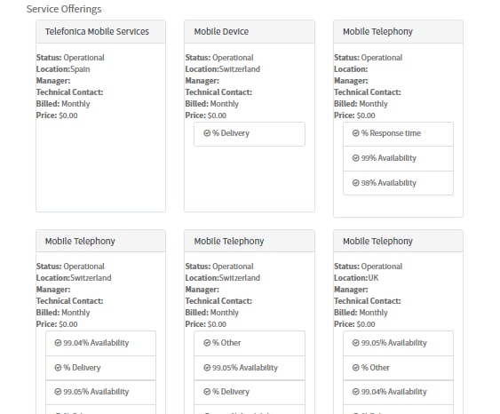

Yes, I can give some examples. In the screenshot below, you see that there are several "cards" that are repeated at the bottom of the page:
The HTML for these is just one line:
I had an array, and i wanted to create a card for each item in the array. The array was an array of objects.
I use ng-include to create a template for each item in the array
As you can see, the object (offering, in this case) contains any unique information necessary to each card. You can see in the second line where I access the widget options.
