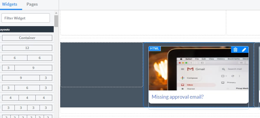

 In service portals we built prior to UI builder, we could add an HTML widget to the page
In the HTML we would point it to a message in sys_ui_message table as shown below.
Then in the sys_ui_message table we would have an entry for each language we wanted to have the HTML translated to.
This way when the user viewed the Portal page the HTML would be in there language.
