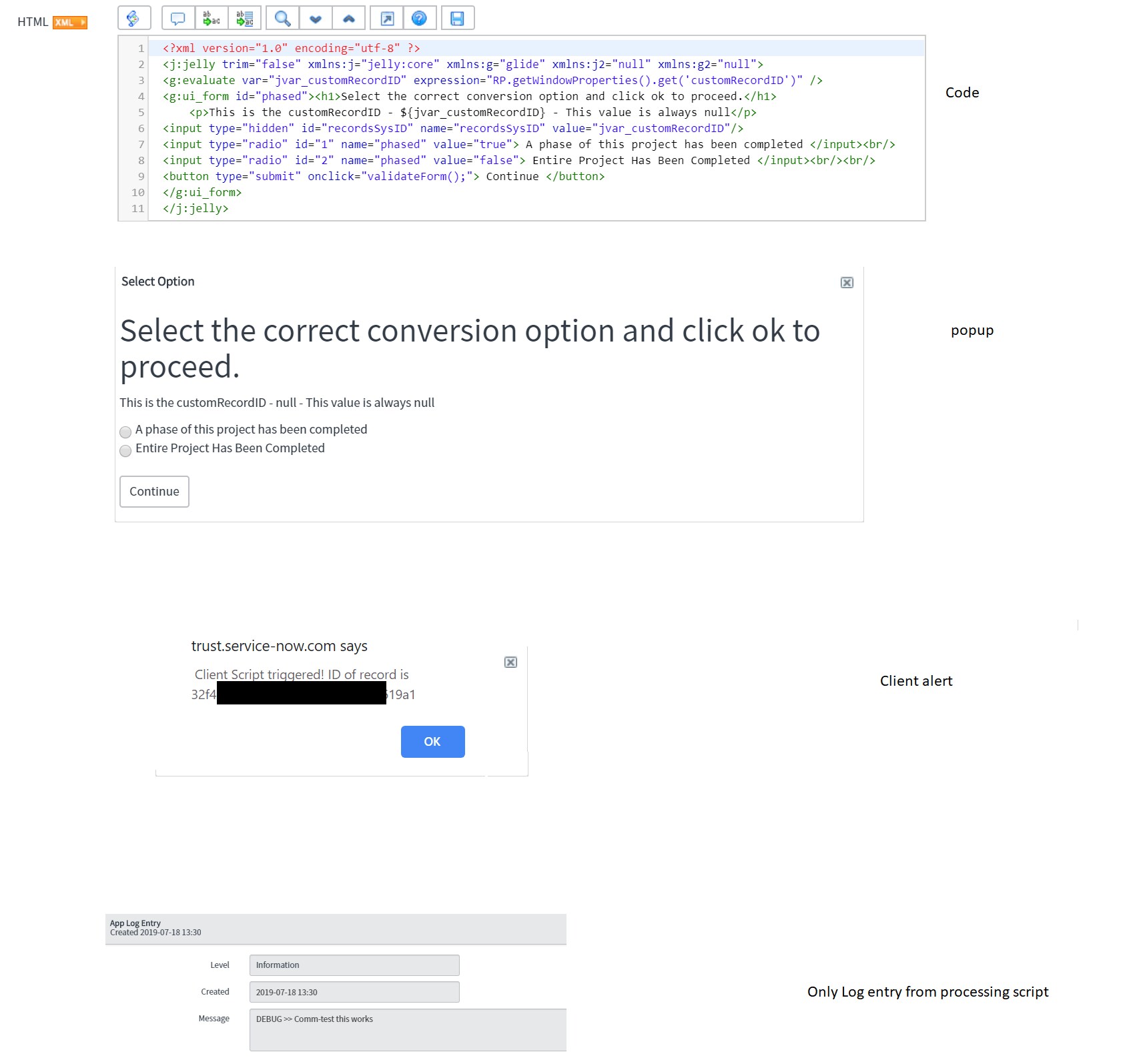

Thanks for your responses. I tried both of your suggestions and it appears neither my processing script or the html are able to access and store the sysid of the original ticket. I included the screenshots below to show the issue.
UI Action Code
function conversionType()
var custom_record_id = g_form.getUniqueValue();
var gdw = new GlideDialogWindow("x_custom_application_table");
gdw.setTitle("Select Option");
gdw.setSize(750,300);
gdw.setPreference("customRecordID", custom_record_id);
gdw.render();
