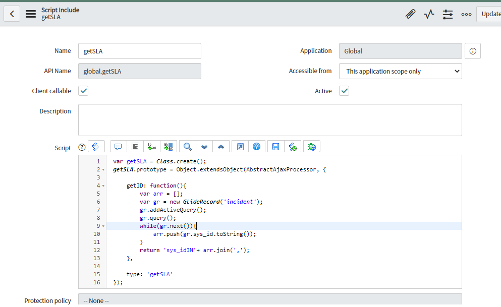

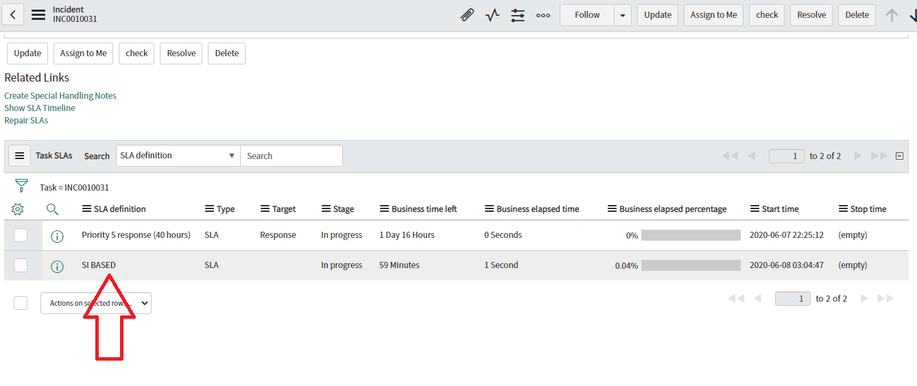

sorry for this question. may i know why are you calling the script include inside the sla ? can you please add your use case ?

‎06-08-2020 04:05 AM
if you see my above screenshot, i used global prefix so can you use that as well in filter condition
would it be possible if you can add some screenshot of you script include and filter condition ?
eg:
sys_id | is one of | javascript: new global.<script include name>.<function name>
