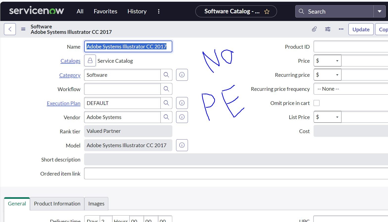

03-06-2024 02:13 PM
Thanks for your inputs. My bad, I would have been more specific on requirement. Your solution perfectly works for direct catalog items. Here what i am doing is, i am converting software model as software catalog by using "Publish to software catalog " related link. After that when i see same in catalog items i don't see Process engine tab to choose flow name(Refer screenshots). Any thoughts.
