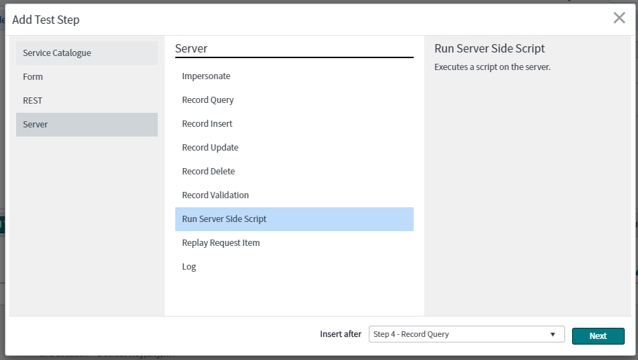

The SN Nerd
Create Step 'Server Side > Run Server Side Script'
Insert the following code:
var waitSeconds = 10;
var waitMs = waitSeconds * 1000;
//Wait 10 seconds
gs.sleep(waitMs);
