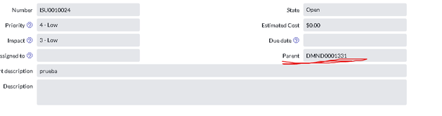

@Leonel Sandroni Can you check if the record has a parent assigned to it?
Yes, it has a parent record
