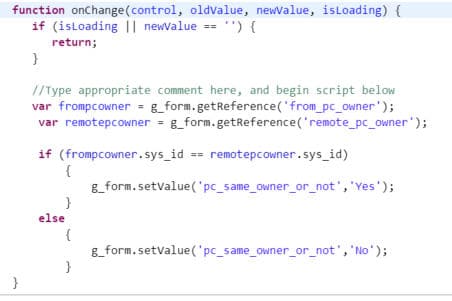

Hi, I'm stuck figuring out how to compare two values to result in a Yes or No in the 3rd variable.
so far,my script looks like this:
Please help.
Thanks!

Can you change it as below and see if it works?
var frompcowner = g_form.getValue('from_pc_owner');
var remotepcowner = g_form.getValue('remote_pc_owner');
if(frompcowner  == remotepcowner ){
  //Set to Yes
}else{
 //Set to No
You dont need to do a getReference for getting the sys_id. The id is directly stored as value in reference fields.
Thanks!

I would go with Alikutty's solution of using getValue instead of getReference. getValue will give you the sys_id of the record in the variable whereas getReference actually does a server roundtrip and grabs the referenced record.
Thank you, it worked! I thought that since the variables are Reference type, I have to use getReference.
Ankur Bawiskar
if those are reference fields then no need to use getReference(); update code as below
if(g_form.getValue('from_pc_owner') == g_form.getValue('remote_pc_owner')){
